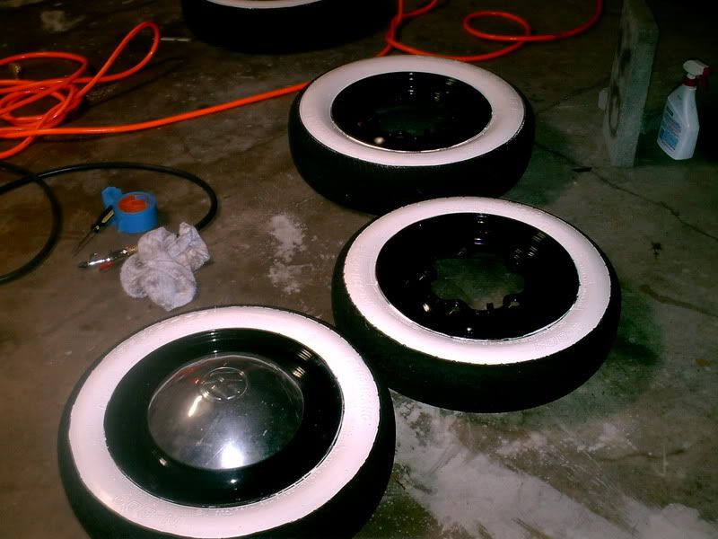

Guest Raggare Posted May 4, 2007 Posted May 4, 2007 http://i58.photobucket.com/albums/g264/ ... oes012.jpg that is what i used for my whites. if done well they will last, ofcourse you will get some discoloration over time. but i think you get some discoloration with porta walls and even real white wall tires. either way, you go through bleah white like a six pack of Cheerwine. this shit litterly turns to rubber. some have used rattle can and it cracks because it hardens. but this stuff has elasticity. the first time i used it, i didn't follow the prep instructions carefully. and after a couple months i trailored my DC to a show and the front tires compressed from being strapped down tight, and the front whites rippled like portas sometimes do. i pealed off the paint and it was litterly a big rubber ring of paint. i redid the process following the instructions carefully and havn't had a problem since. $60 for four white wall tires, is a hell of a lot cheaper than if i bought white walls. plus i got to choose the thikness of the white band. Quote
