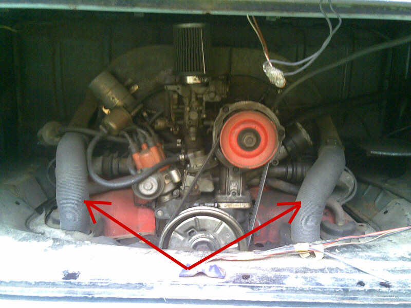

Now this will seem like another stupid question but what are these pipes called and what do they do? As far as I can work out they take hot air from the exhaust/exchangers and put it back through the fan so are they there to speed up the engines warming up?
If so can I take them away (when putting in a karmenpesa exhaust)?

they are called fresh air hoses, and they blow air from fan shroud to heat exchangers and further on to the cabin. if you plan to use heat exchangers with your new exhaust header, you can buy longer hoses so you can clamp them to the heat exchangers. or if you use j-tubes instead of exchangers, plug* those airlets on fan shroud and put some sheet metal on holes on that engine tin over exhaust so that hot air cannot rise to the engine compartment.
(*research says that the best cooling is achieved when they are not plugged fully, there should be some 'leak' so that original desing of fan shroud is in it's best use, for example vw thing doesn't have those snorkels in it's fan shroud and the inside of it is different also vs. type1/2)

Of course! I was thinking backwards. they blow the air into the exchangers and forward to heat the cabin - not the other way round. I like the idea of lengthening the pipes - although it may be a tight fit. I'd go the J Pipe route but I don't like the idea of having no heater - at least to de-mist the windscreen..
