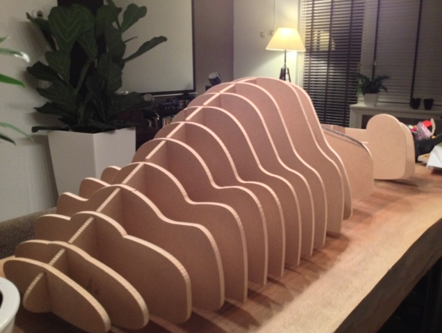

jaraku Posted February 26, 2015 Share Posted February 26, 2015 hebsteri tekee kyllä nopeempaa tuollaisen muotin, ennen kun ton saa lainaan.. Quote Link to comment
Tanhis Posted February 26, 2015 Share Posted February 26, 2015 Niin no pikkasen ehkä oli huumoria mukana edellisessä postauksessa. Quote Link to comment
Hebster52 Posted February 26, 2015 Author Share Posted February 26, 2015 Askartelua olohuoneessa... :) 1 Quote Link to comment
jaraku Posted February 26, 2015 Share Posted February 26, 2015 aika hyvä luuranko he heeeeeeee he. Quote Link to comment

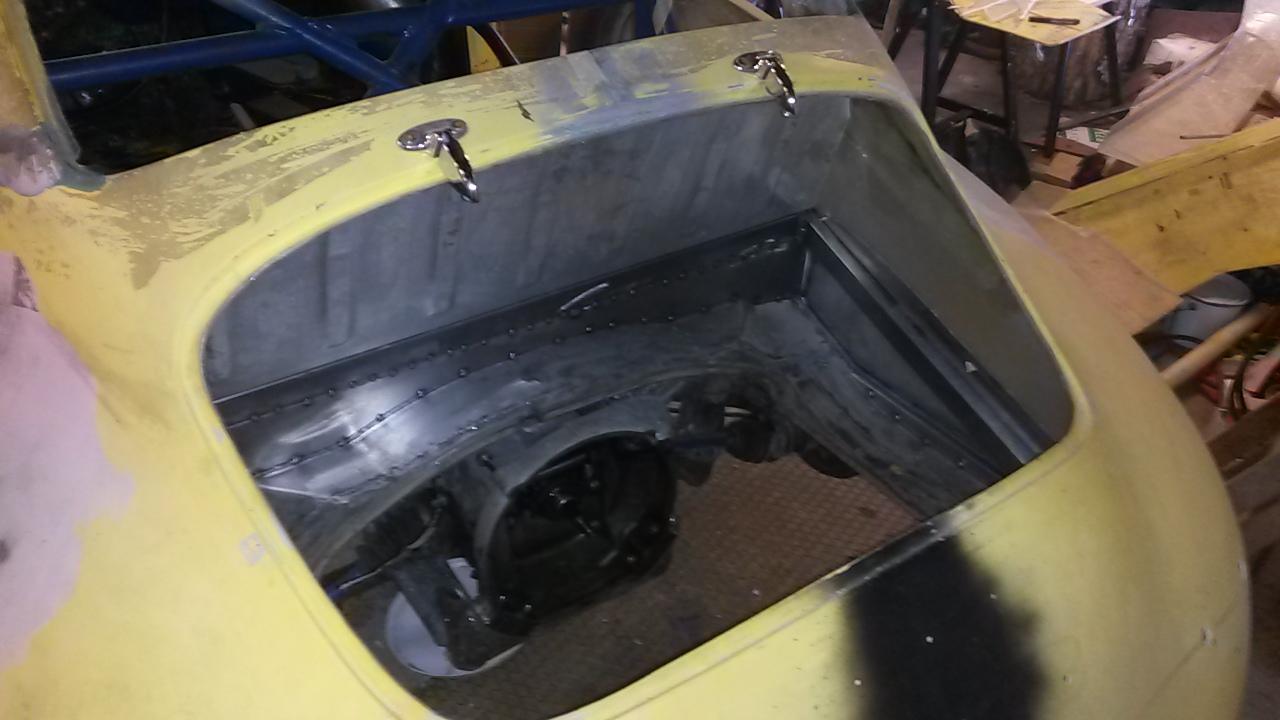

Hebster52 Posted October 7, 2015 Author Share Posted October 7, 2015 (edited) Konehuone kun tiputin koneen pois jotta pääsen viimeistelemään pintoja. Edited July 25 by Hebster52 2 Quote Link to comment
